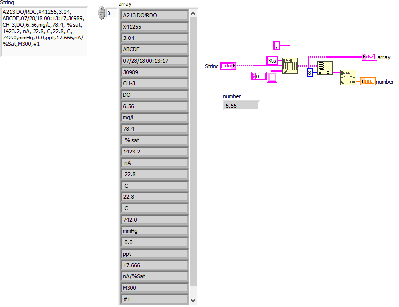

Accepted by Augspurger
Here's what I had in mind (using spreadsheet string to array), assuming that all commas are field delimiters.
