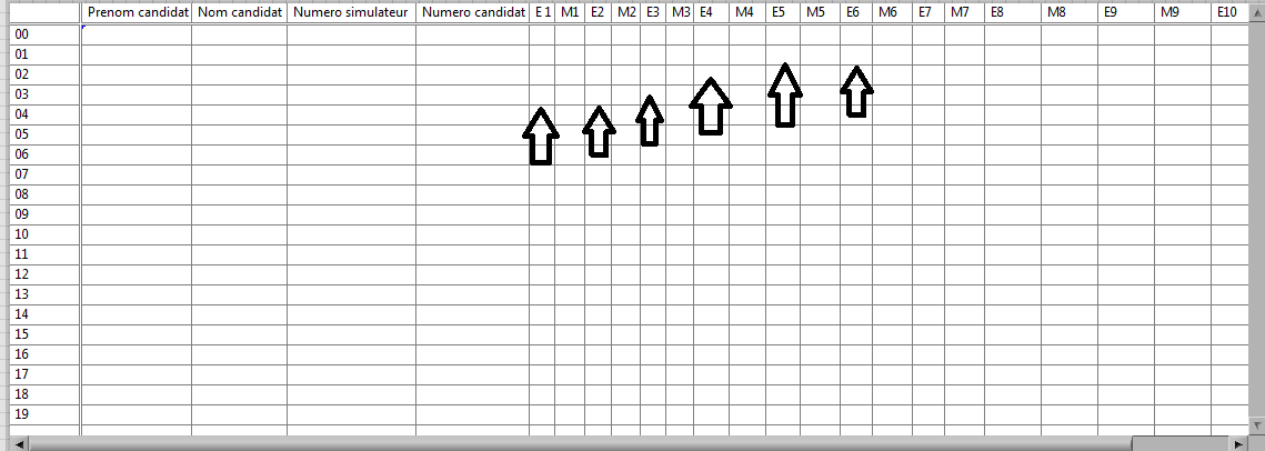

I want to get this table in excel and in front of each row a graph drawed using just the value of E1,E2, E3, E4, E5 ....E10 ,and in the table ,for the columns M1 M2 ....M10 the have to contain either yes or no ,if yes the cell has to be green if ni the cell has to be red.
i'm wondering if there is a real solution to solve thoses 2 problems

1-i want to export this table to excel sheet

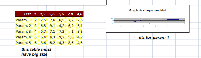

2-because those values are numeric and each one represents elapsed time in a test ,so i want to get a graph from thoses values for each student,and in front of his row.i think i must have big rows so the graph will be clear
3-it's about a maintain,so it has either true or false(booleen),if it's true>green otherwise > red

To move the table contents as well as generating the graphs, you may want to consider the possibilities outlined in this article.
As for painting the cells from columns M1 and M2 green or red, you have to check the condition manually and then apply the format change.

i decided to change the way of getting graphs,it's not really evident.i'm now thinking to get each row in a different worksheet,so the data and the graph for each row will be in a great size.
if you know how i can program each row in it's specific worksheet
