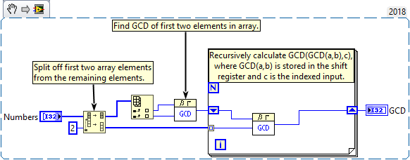

For anyone coming across this now, this is a much more performant and easier to understand solution:
It recursively uses the shipping GCD VI instead of using the prime factor method.  (I suspect that the GCD VI didn't exist back in 2006 when this post was originally made.)  VI is attached.

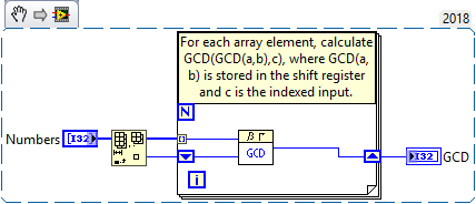

(Be careful with the wording, this has nothing to do with recursion. I am also not sure what "much more performant" means. Do you have relevant benchmarks?)
In any case. Your version still seems overly complicated. You only need exactly one instance of GCD.
Here is equivalent, but arguably simpler code. 😄

Thanks for calling out my sloppy use of "recursion" and for providing the simplified code!  Yes, I did benchmark it per Darren's brainless LabVIEW benchmarking best practices to be multiple orders of magnitude faster than the original solution.  Here's the snippet for those looking:
Most likely things could be improved even further by taking advantage of the fact that we are dealing with an array. For example if we would sort the array in a certain way first and then use code tailored to that fact. I have not tried.
Message 9 of 15
(6,557 Views)
I don't doubt that.  In my case, I was just trying to find the GCD of the sample rates of data sets captured across several (5-10) different instruments running at various rates.  I used this post as a starting point, spent about 15 minutes improving it, saw massive gains, and moved on.  For much larger data sets where performance is critical, I'm sure more mathematically capable folks than me could come up with something stellar 🙂
