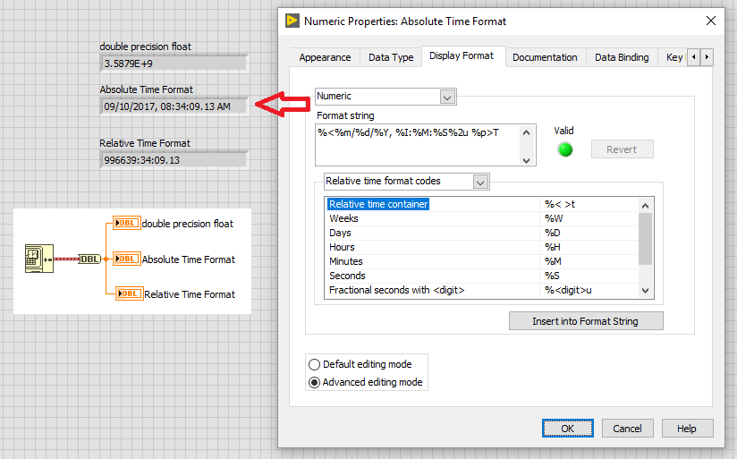

It is the same value, just with less resolution (coerced to DBL) and is based on the LabVIEW epoch as has been mentioned (you can find the definition here).
If you want to see the value in a more recognizable way, just change the format of the indicator. Same difference! 😄
All three indicator have the same "value", it is just displayed differently.
