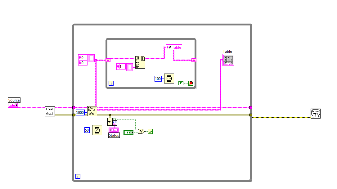

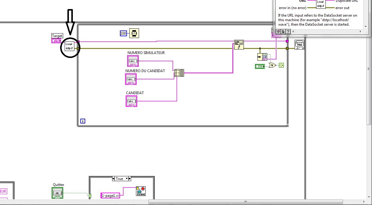

i want to enter data in my 1st vi ang get them in a table in the 2nd one,but i can't.
if someone know the solution
the 1st one is :emetteur
2nd one:recepteur
i think my problem is here

thanks for your answer i want to enter data in "emetteur. vi" and get them in a table in "recepteur.vi" using datasocket
.for the vi below launch ds server to get it you have just to open find examples in labview and in earch for datasocket then open the example"DS reader"and just copy past the icon of the vi below2014-04-07_2105.png

achfire,
After being able to look into your code, I think you are almost over complicating things. I looked into these 2 files, the ones that are attached, and they use the DS server and communicate very effectively. These programs are just taking from LabVIEW program examples but show the simplicity in using the DataSocket.
