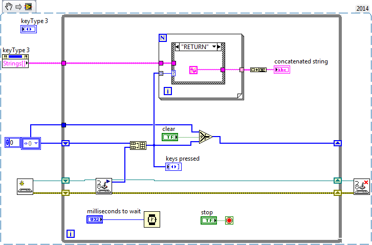

I have the barcode scanner (kb-emulation).
I need to get data from it IN shadow loop.
I.e. I have main window where is user interact with the application. And if the user scan code, the data should be checked in DB and another processing.
So, I can't use string control, event structure etc.
Vi from connectivity -> inp dev control has some trouble.

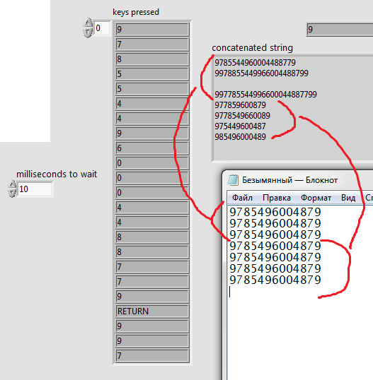

If I set small timeout, I recive dublition simbols, and if I set normat timeout, I can loose data (see screenhots).
And the same time in notepad (emulation of main window) I get normal data.
How can I get correct string data?
