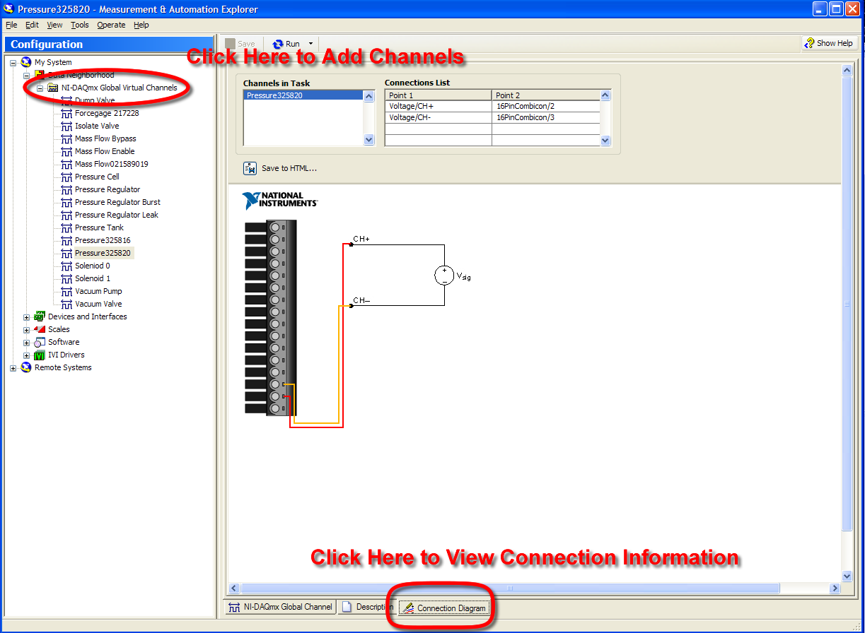

One really nice thing that NI added a while back was the help in Measurement and Automation Explorer that shows how to attach the sensor to the Daq card. If you click on the measurement and automation Icon.
20123iEC012557552353C8
The program starts. Click the DaqMX Global Virtual Channels and add the type of device that you want to add. It will take you through a few steps then it will show you how to connect to the device.
20125i91785846EB51E333

That connections diagram is a nice faeture!
Another one that I use to get started starts at the same screen but a tab over where you can use your task in MAX.
If you go and save that task you can then go to LV and...
1) Drop a DAQmx task and choose the task you saved in MAX.
2) Right click on it and choose "generate code and configuration"
LV will generate all of the code required to match your config in MAX.
At that point you can re-write it correctly Smiley Wink and ge the same results you saw in MAX.
