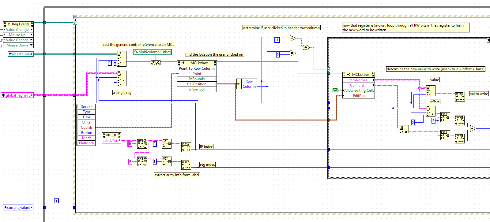

I am using a dynamic event registration node to register an array of references to my multi column listbox.
However, the dynamic event registration node is limited, and doesn't let you choose (for instance) Edit Cell as an event to trigger on.  Inside the event structure, I use a Point to Row Column function to determine where the user clicked, then I make the cell they clicked on the Edit Position so they can enter a value.  I want to write the value they enter out to a subroutine.
This partially works.  The event triggers on the mouse down event of the user clicking, which is what I want so that they can edit the cell when they click on it.  But the problem is that my code samples the value at the time they click and writes it out, before they've entered their new value.  In other words, right now it only works if they click to enter a value, then click within the same cell after they're done, thereby triggering the event structure again and causing their new value to be written.
Basically, I only want to write a new value to the subroutine (not shown, but the wire below the "val to write" comment on the far right goes straight to it) if they enter a new value (although it's not a big deal if it writes it even when they keep the value the same).  In other words, it's like I want it to 'wait' after they have clicked to edit a cell for them to either press enter or click outside of the cell, and then write the value they entered.  What's the best way to handle that while using dynamic event reg?
