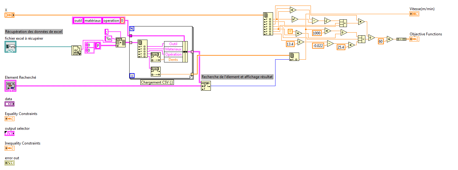

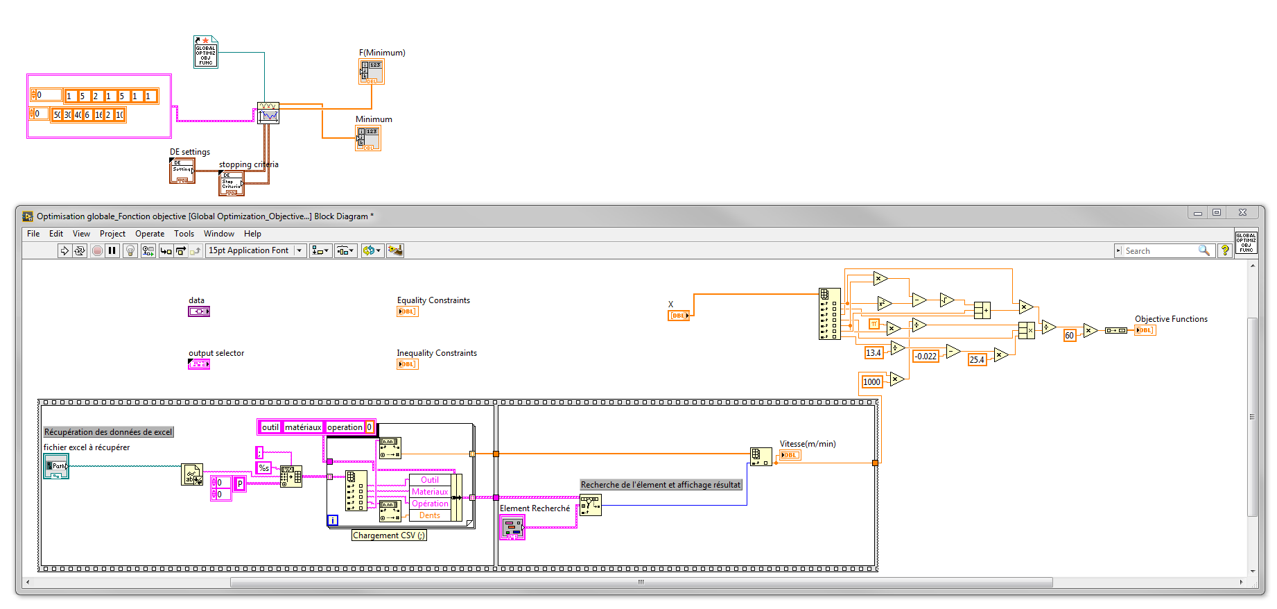

I have a little pb with my application, i have tried to use a global optimization but my VI reference doesn't work(where there is the objective function), because i have a Flat sequence  in the Vi (it is necessary to seek a value from a excel file),to be more precise i attach my VIs

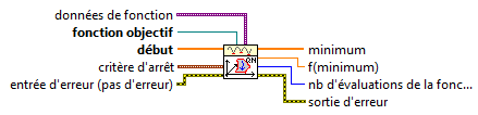

i m using mathematical Optimization, this one: optilisqa.PNGI have two VI, one VI its the global_Optimization and the second on is Optimization phase_avant( where im using the MATHEMATICAL vi Global Optimisation which objective function is referring to the first VI)

Oh. Okay. Well I dragged your VI to the VI reference without changing anything and it works. No broken run arrow.
Open both VIs > Drag the icon from the top right of your Global Optimization VI > Drop it on on the static VI reference

Yes it works but the result of the optimization function f(minimum)="Inf",  i dont know why?

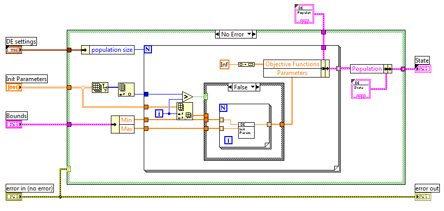

Well I'm not familiar with this function, but you can trace down in to it to see where the Inf comes from. It looks like it gets set as a constant within the Init VI. Thi Init VI goes to that case only if Population initial value is empty. So if you want F(min) to have a value, you need to set an initial condition for your population using the Beginning State input.

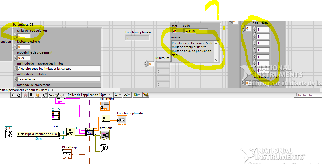

When i try to add initial parameter on begining state, when i run the program, i have this code error:error2.PNG

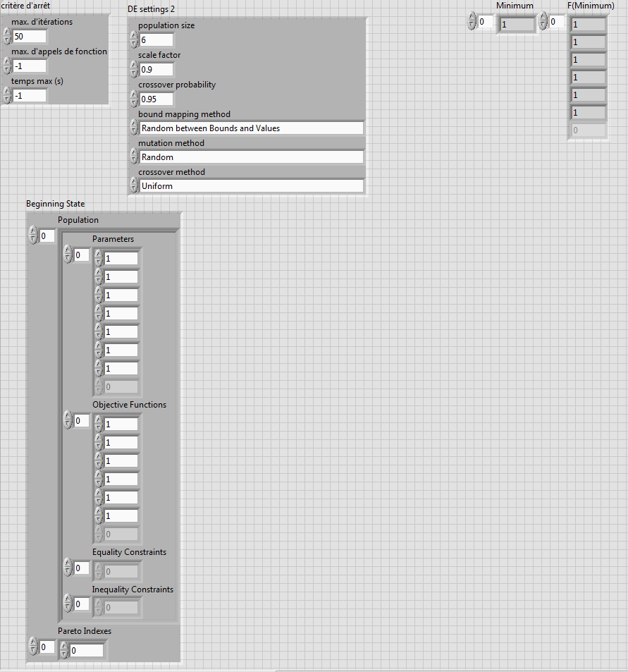

You need to set Objective Functions to be a large enough array as well. This worked for me:
The values and what to input, that's all up to you and your requirements.

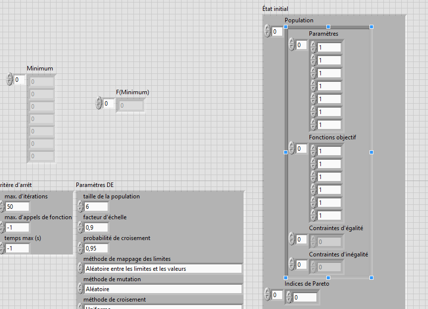

thanks for your respond, but it doesn't work for me; i do the same thing i have still the error message:
