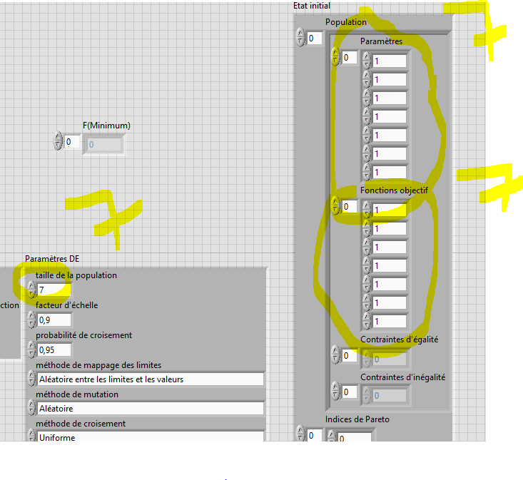

You didn't do the same thing. You need to make the array inputs as size 6. From what I can see, yours are at least 7 elements. Right-click and got to Data Operations, then Clear Array or Delete Element.
(I say 6 because that is what your Population Size value is. The number of elements in the arrays we're talking about need to match the value for Population. Read the error message. It says as such.)

i understand that, but even if i smatch the array size with the poulation size, i have the same error,  have 7 elements and istill_error.PNG

Are you sure you have 7 elements? If you scroll down, is there anything there? The VIs you've included have empty arrays, so I can't see exactly what inputs you're using.

i have the exactly 7 elements for each array:

Well then there must be something else causing the error. Go to Edit > Set Curent Values as Default, Save, and reattach your VIs, so we can see exactly what your settings are. Is it the same error still?

Aha! You need to set "Indices de Pareto" to a single element, not 7. I think this is because you have a single element Population array.
Now all of this said, I repeat, I am not familiar with the function or what you are doing. You probably shouldn't be just messing with the inputs until the VI runs and hoping to get outputs that actually mean something to you. Do you know why you're using this function? Do you know what to expect as outputs?

See my attached VI. It runs because the Population array has to have 7 elements and the parameter array need to match the bounds that you have set.
As far as using LabVIEW for optimization, it can be done. Have you looked at the examples related to this specific VI to see how that compare to your application?
Refer to the following VIs for examples of using the Global Optimization VI:
  • Find Global Min on Surface VI: labview\examples\math\optimiz.llb
  • Two Circles Optimization VI: labview\examples\math\optimiz.llb
