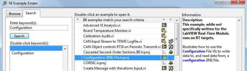

Hi Bochev,
yes, it's all possible...
(5,147 Views)
Use the Example Finder and examine the use of the Configuration File palette.
Jim
