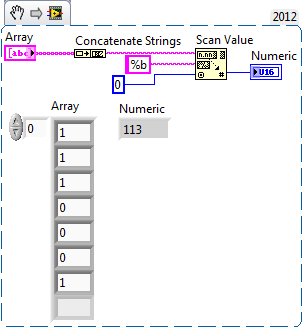

I'm on LabVIEW 2012 and I can't open your VI, nor Hoovahh's modified version, so perhaps I'm posting exactly the same thing, but does this snippet do what you want?
(3,503 Views)
That is more elogant than what I have
