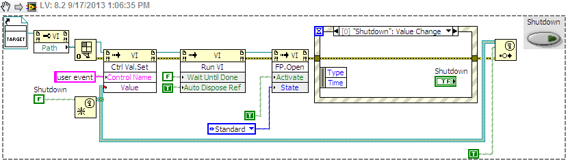

I'm a little hesitant to suggest User Events to a CLA, but...
Jim
(3,102 Views)
Accepted by topic author GabbyG
Main VI creates the user event and launches the target:

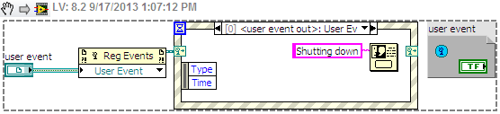

The target VI waits for, then handles the event:
