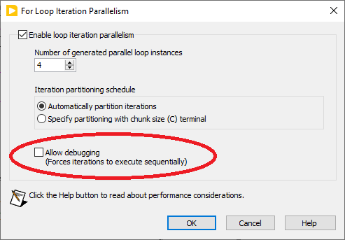

Is that probe inside a parallel FOR loop?
(You cannot probe inside a parallel FOR loop unless you temporarily change the options for it, forcing sequential execution)
