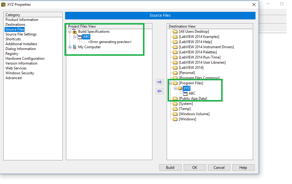

i have created the executable from my project and now creating installer but my VIs that are in project and also in execuatiable are not showing in installer as shown in figure ..please help me

thanks for your reply Sir, i just want to create installer exe so that i can install and run without labview software anywhere. up till now i learnt for creating installer firstly you have to create executable and from executable you can create installer. i have created executable and it work fine, but now creating installer is difficult for me as it can be seen in picture when i add my executable to the program file it doest have all the VI that are available in my executable and that's why if i create my installer it doest work without labveiw..
I think you are failing to understand a few things:
  1. The executable is "all your VIs" crammed into one file that can be executed via the (correct) LabVIEW runtime.  No need to install the VIs.
  2. While it's true that you won't need to install LabVIEW to run a LabVIEW executable, you still need to install the LabVIEW runtime.  (If you think this is odd, it's not.  For example, you need .NET runtime to execute anything .NET.  It may not seem that way, but that's only because the .NET runtime is often already installed on a computer, so most installers skip that step.)
So add your executable to the installer build, then build it.  Install it on your computer and run the executable.  Install it on a computer that has no NI software on it and run the executable.  If it works for all those scenarios, pat yourself on the back, knock back a few beers and call it a day.  🙂

yes sir it is on its own place, because if i remove it from its place than it did not run at its place. in picture you can see project is coming above from my computer although in videos on you tube my computer is above of all.

Yes, there is clearly something wrong because of the <error creating preview> message in the middle pane. Unfortunately you don't give sufficient information for us to troubleshoot the problem.
