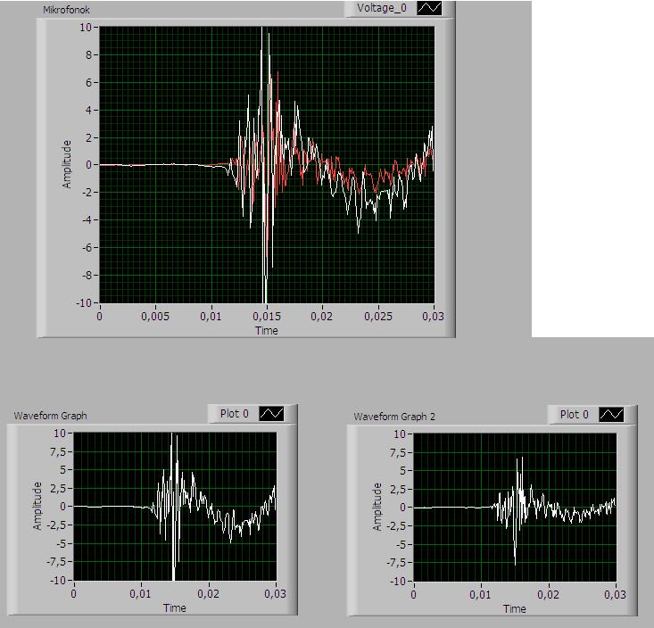

I have a Daq Assistant, it acquisist in N Sample mode with 34k Hz (rate) and one Sample is 1k long. I acquisit 2 signal.
I make a Crosscorrelation with my 2 signals (with crosscorrelation.vi).
I wan't to calculate the time-delay in milisec between the two signal.

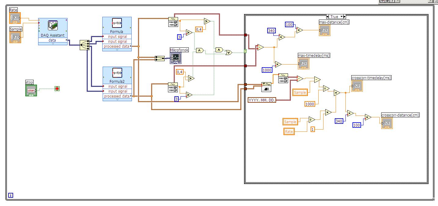

Here is what i have done:
Is it OK? I think, there is a mistake in it...

Sorry, I don't have DAQ. Can you rewrite it for simulated data (or simply provide some typical data).
I don't understand why you use local variables for rate and sample. Simply wire from the terminal instead.

I had make some signal with big noise... It's really not the same...I acquisit my signals from two microphone, so generally it looks like 0V witha bit noise, and when i clap for example, 3V and 7V and 0V again...
I use local variables for rate and sample, couse i don't wan't a lot of wire...
Is it not good?
