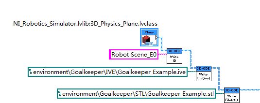

In LVR 2011, if you want to create your own environment model, please first look at this VI <LVR2011>\examples\robotics\Simulator\Goalkeeper\Create Manifest File.vi. It defines how to use scripting to generate a simulation profile(XML file). The following picture shows how to define the environment.
The Goalkeeper Example.ive file is exported from Google SketchUp. LabVIDEW can load and render the visual model in LV 3D picture control.
The Goalkeeper Example.stl file is the mesh file of the vsual model. LabVIDEW can load and create a model for collision detection and other physical simulation features.
If you want to create a new environment model, you need to draw it in a third-party CAD tool, such as Google SketchUp/SolidWorks, and then export as .dae file and .stl file. Then you can use LabVIEW 2011\vi.lib\robotics\Simulator\Interface\Utility\Converter\CAD Model Converter.vi to convert the .dae model to .ive model. Then please copy these two model into \LabVIEW 2011\resource\robotics\simulator\CADModels\environment\, and update the paths showed in the picture. Run the Create Manifest File.vi and you will get an updated xml file.  When you run the example, you will see the new environment.
Again, this is a pretty complex way. We realized the limitation and are working on the direction of enabling user to customize robots/environments easily. Please let me know if you have any question.
