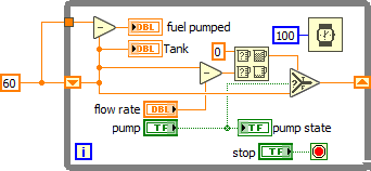

Here's a simple draft that drains the tank whenever the pump is on and the level greater zero.
You should be able to add your other requirements, such as money input and cost calculation. For example turn the pump off if you run out of money or run out of fluid.
This is intentionally just a picture. try to implement it and try to understand the reason for every single detail!
It is nowhere complete and just serves as proof of concept for part of your problem.
