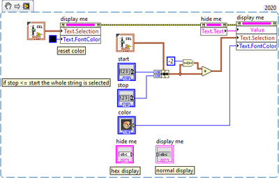

So text displays in LV have two components, the data and the style information.  The style information for a display is stored in a series of 'runs'.  Each run has a start position and a length.  The added spaces are treated (appropriately) as part of the style, unfortunately, the way it is implemented is that the spaces are added after every two bytes within a given run, you see the results when a new run is started at an odd location.

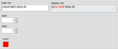

My suggestion is use a hidden string control set to hex display to receive the data.  Use the Text.Text property to get the hex string (spaces included) to display in a separate indicator set to normal display.  Now you can use the Text.Selection properties along with Font.Color to highlight this string.  With the included spaces, just remember that index += index << 2 (ie. index = index + index/4)
You can easily change the math to index by bytes instead of using the raw location like this example.  Remember that the stop location is not inclusive as well.
