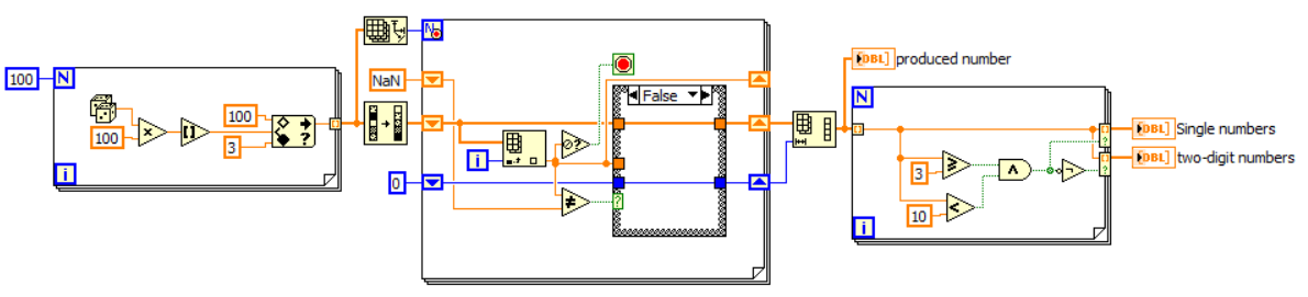

Hi arvin,
this is not the explanation we expected from you…
But I removed some of your Rubegoldberg code and implemented a solution to your problem:
Use the free online courses to learn about shift registers, array handling, conditional output tunnels - and try to avoid local variables and RACE CONDITIONS!
Also learn about polymorphism. And why did you use InRangeAndCoerce in one place (left loop) and not in the other (right loop)?
(3,211 Views)
Didn't trust it to work more than once?  This has to be an assignment right?
