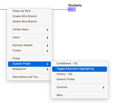

There's also this when you right-click a wire:
Message 16 of 17
