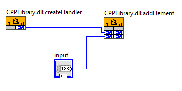

How can I pass that pointer to other function definition. Here I would like to pass the return value of createHandler() funcation in to addelement().
I try addElements() definition like below but none of them work correctly.
void  addElement(int64_t arg1, int64_t arg2);
void  addElement(int32_t arg1, int64_t arg2);
void  addElement(int32_t arg1, int32_t arg2);
By doing pointer as first arguments labview program crash
void  addElement(int32_t *arg1, int32_t arg2);
void  addElement(int64_t *arg1, int32_t arg2);
void  addElement(int32_t *arg1, int64_t arg2);
void  addElement(int64_t *arg1, int64_t arg2);
Here the block diagram which I try
what is correct way to use that pointer in another function of library?
Message 4 of 9
What is correct way to pass the createHandler() function pointer to other function of Library?

What's the purpose of wrapping the object pointer into a cluster? Why not just do it like this:
/*wrapper.h*/
#ifndef _WRAPPER_H_
#define _WRAPPER_H_
#ifdef __cplusplus
extern "C" {
#endif // __cplusplus
 struct CPPLIBRARY_EXPORT cPlushandler;
 typedef CPPLIBRARY_EXPORT struct cPlushandler cPlushandler_t;
 CPPLIBRARY_EXPORT cPlushandler_t* createHandler();
 void CPPLIBRARY_EXPORT deleteHandler(cPlushandler_t *m);
 void CPPLIBRARY_EXPORT addElement(cPlushandler_t *m, int a);
 int CPPLIBRARY_EXPORT getElement(cPlushandler_t *m, int index);
#ifdef __cplusplus
#endif
#endif // !_WRAPPER_H_
/*wrapper.cpp*/
typedef void *cPlusHandler;
cPlushandler_t createHandler()
	return new CPPLibrary();
void deleteHandler(cPlushandler_t o) {
	if (o != NULL)
	    delete static_cast<CPPLibrary *>(o);
	return;
void addElement(cPlushandler_t o, int a)
	if (o != NULL)
               CPPLibrary *obj = static_cast<CPPLibrary *>(o);
	       obj->setValue(a);
	return;
int getElement(cPlushandler_t o, int index)
	if (o != NULL)
	    return obj->getValue(index);
        return -1;
Now you can configure the return value of createHandler()  to be a pointer sized integer and also all the class object parameters for all wrapper methods the same.
In fact you could even completely skip the declaration of cPlusHandler_t and just use CPPLibrary * everywhere instead. That would get rid of the static cast too. There is a use for static casts in C++ but LabVIEW does not care about C++ typesafety. For LabVIEW a pointer is a pointer is a pointer, if you get my drift. And LabVIEW does nothing with that pointer other than treating it as a 64-bit integer on the diagram and passing it as 32-bit or 64-bit integer on the stack to the DLL function when the parameter is configured as pointer sized integer.
If you want typesafety in LabVIEW you have to wrap this pointer into a LabVIEW object and create object methods that will call the DLL exports.
