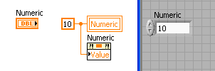

You can use Local Variables (and Property Nodes) to programatically set the values of controls after you have read the spreadsheet.

It may be unclear from the picture I posted, but use one or the other.  Using both does nothing for you.  Also, if you have to choose between the two, use the local variable.
If you don't know how to get one, right click on the control then create local variable.
