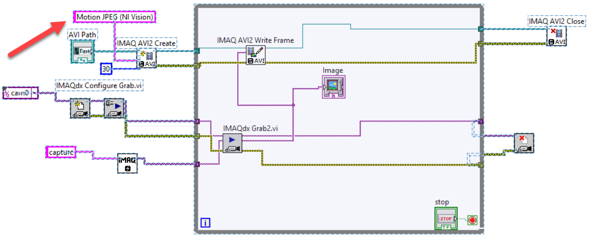

@Bob_Schor wrote:
In AVI2 Create, you need to specify a Codec.  I don't know what Codec is used if you leave it blank, but I tried your code and it did run fast.  I used Motion JPEG (NI Vision), and it worked just fine, seemed to even have the correct timing.  And was a factor of 10 smaller than the earlier file that ran "too fast".  Try adding the Codec and see if it fixes your code.
Bob Schor
Here is a picture that is your VI with the change I suggested in the above response:
Bob Schor

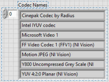

@touitou wrote:
I didn't know how to create Motion JPEG in the codec,please if you can help me and modify this VI from me,thank you so much.
Sorry, I'm "on the road" and didn't carefully read your question.  There's a function on the AVI Palette called IMAQ AVI2 Get Codec Names that returns an Array of Strings.  I simply chose (and exactly copied) the Motion JPEG string.  On my system, this is the function and its result:
Get Codec Names.pngCodec Names.pngBob Schor
