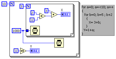

how can i write this C-Code in G-Code
hallo
how can I write this C-Code in LabVIew ,
for a=0; a=<10; a++
   for b=0; b=5 ; b+2
        X= 3+b;
  Y=1+a;
please see the attachment and tell me where is the problem

I can't open 8.5, but I would suggest you use a For Loop

Well, at least you tried and got some of it right. Smiley Happy
I think this should do what you want, but my C is rusty. Is the increment performed before or after the loop executes? If it's after, then I believe the loop should iterate 11 times, not 10.
In any case, you should note that for a literal translation, you would need to add a sequence structure to guarantee that Y was written to only after the inner loop finished because of the way data-flow works.. Also, note that controls and indicators in LabVIEW are not equivalent to variables. They can be used as such, but they usually should not be.
Another point about this is that you probably want to use the correct data type - the orange terminals are floating point indicators (of double precision, in this case) and you want integers.
To learn more about LabVIEW, I suggest you try looking at some of these tutorials.

tst, that would give you b=0,2,4
Which I believe is correct, since b is initialized to 0 and the increment is b+2.

Although, then I don't understand how you can get to b=5.
