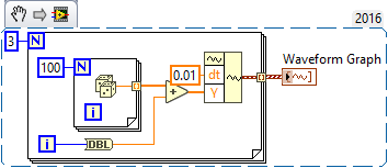

Do you understand how a Waveform Graph works?  If you have a waveform, you simply plot it.
LabVIEW is logical and simple enough that if you don't know how something works, have not studied LabVIEW, and don't bother to read the Help for LabVIEW functions, you can build a simple little VI and test it to see what happens.  Before running this routine, think about it, make sure you understand what each function does and why it is there, then predict what will happen when you run it.
Bob Schor

I showed you how to arrange data by rows (more-or-less -- I really made a 1D array of Waveforms, so if you think of the Waveform as being a "row", then it is a 1D array of "rows", i.e. each Waveform is the "next" element of the array).
You want a 2D array, and you want successive elements in columns, not rows.  Do you know what an Array Transpose is?  And why do you care whether it is rows or columns, anyway, unless you are worried about how it "looks on the page"?
