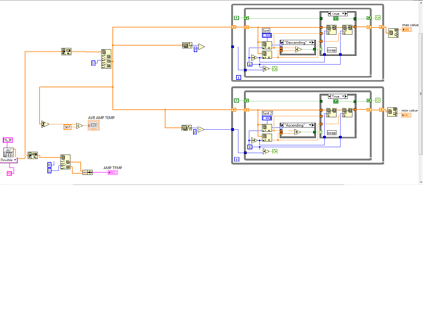

hihi i have problem too. my minimum value is always zero how can i alter it? I will be given a whole list of raw data and i have to open it using labview then find the min max and average of the data . everythinUntitled.pngg work fine except the minimum value
Code pictures are useless. Please attach a real VI, including some typical data.
