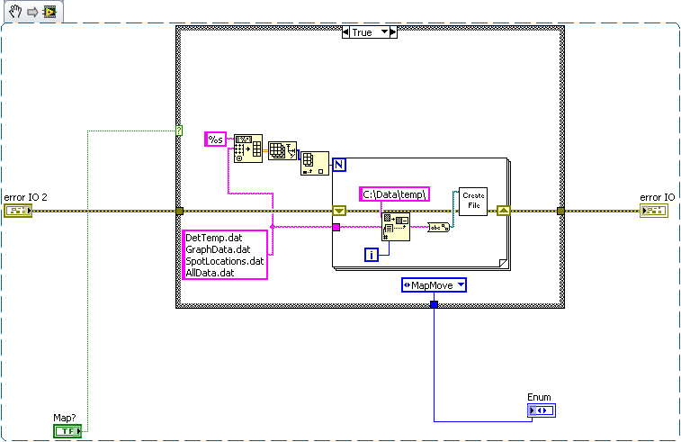

First I am writing arrays to binary files, then later retreiving them to store them in an .hdf5 for optical characterization of Transparent Conductive Oxides.  So when I first create the .dat file it is with the following while loop:
The internal 'Create File' is this:CreateFile.png

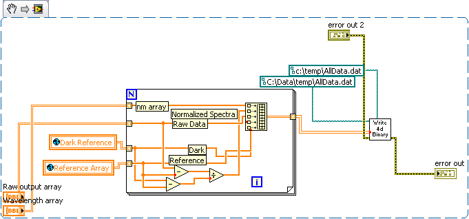

The data is coming from different spectrometers, and it is outputted as an array.  Here is where the data is collected and written to the binary file for compression, and so LabVIEW does not take up all the computers memory when measuring a lot of spots on the sample:

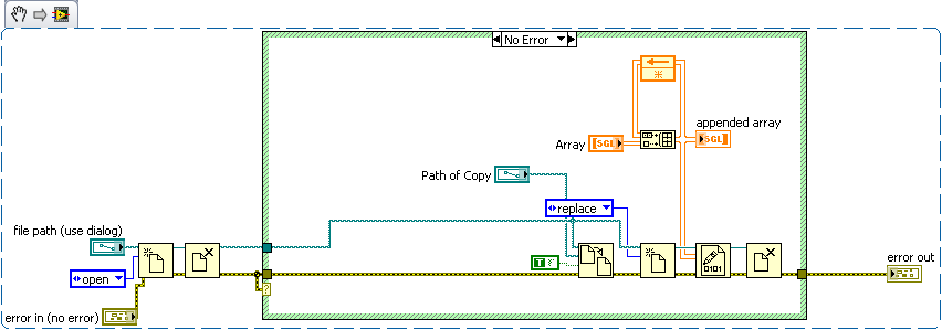

and the 'Write 4d Binary' looks like this:
So here are the internals, and yes how do I delete the data from memory so when I measure another spot on the sample it starts with a blank slate?  Do I use the 'Flush File' code, then delete that newly created file?

Ravens Fan was correct!
You are not deleting your old data.
Your problem is the uninitialized feed back node.
It holds all your data from the passed runs
You need to feed an empty array into initialing terminal.
Omar

I have never seen a 4-D array in actual use before.
You are not clearing your data.  In the second snippet you posted, you are continually appending new 3-D arrays to you 4-D array.  You are maintaining that 4-D array with the feedback node.
What you need to do is when you want to clear that 4-D array, to wire an empty 4-D array into that feedback node instead of the result of the Build Array function.  You can use a select function or a case structure to choose between the results on the wire and an empty 4-D array constant depending on whatever boolean condition you use to determine the array needs to be emptied.
