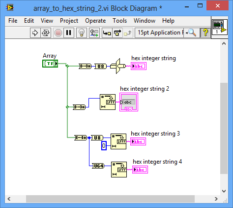

how do I get an actual hex number from an array. The array to hex converter produces two characters rather than a hex number.
Hey I got an exceptionally long boolean array - 544 elements, none of the techniques work as per the attachment to convert it to a HEX string.
What is the solution?
See attached VI...
common techniques to convert boolean array to hex string in LabVIEW
(these all produce wrong results)
However, your attached example has only a boolean array with 8 elements. Can you make a more relasistic default value?
Then please tell us what the "right" result is. Since there is an infinite number of wrong results, but only one right result, we cannot conclude by elimination.
@kate2012 wrote:
... to convert it to a HEX string.
What is a HEX string? Do you want a binary string where each character corresponds to eight of the booleans or do you want a hex formatted string of that above result, exclusivley containing characters 0..F, or something else.

OK, try something like this....  (LabVIEW 2012)
Even if it is not exactly what you want, it might give you some ideas. If one of the solutions is as desired, delete all the unecessary code. 🙂
