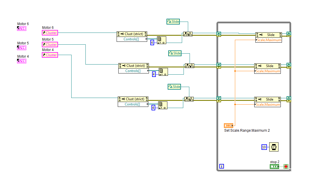

(9,885 Views)
If you want to change the maximum all at the same you will need to write the property nodes at the same time. By moving the control inside the loop you can change the value of the max range while the program is running. I suggest some error handling as well. This was just a quick example to answer your questions from the previous example posted. I just coped sections of the code that was previously posted to get the following picture.
I had to use a 4 instead of a 3 because I manipulated the cluster to check a few things. To check this on a cluster, right click on the cluster type define then select Open Type Define. Right click on the cluster in the type define (on the edge) and select Reorder Controls in Cluster. You will see the order numbers for the controls. In my case the slide control was 4.
Brad S. | National Instruments | CLA
