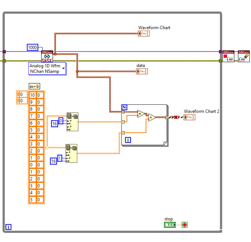

Well, what about scaling with different constants and adding different constants of array like Ax+B to all channels.
This would help much for me.

But still getting an error like below. How can I solve this?
Best Regards,
Bertan
Message 6 of 9
(4,300 Views)
Hi Bertan,
why do you need a FOR loop? Why do you create a 2D array of waveforms?
Why do you work with 2D arrays? (Use IndexArray instead of ArraySubset!)
It's all your fault… 😄
Message 7 of 9
(4,285 Views)
I would use the DAQmx scales so I wouldn't have to worry about doing the math on my own.
But with your setup, you really should wire your 2D array straight to the FOR loop, autoindexing on it.  This will iterate over the row.  Now you just use Index Array to get the two elements in your row and multiply by the first, add the second.
