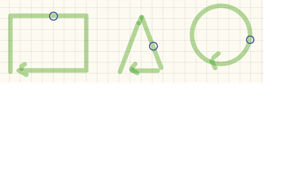

how do i animate a continued smooth motion of a small marker around
How do i get started in creating a VI
to animate the continued smooth motion of a small marker around a series of geometrical shapes on a display.
Im a newbie in labview and any help will be greatly appreciated.  I also need to
Add controls to select between shapes, size and speed of rotation and direction of rotation.

Define your shapes as an array of points. Each point can be represented as a cluster of two doubles (your x and y coordinates).
Split your points into separate x and y arrays and pass the to an XY plot to display it. You will have to add a copy of the first point at the end of the array to close the shape.
Use a while loop that updates your spot location continually.
Choose a time step in seconds.
Distance travelled in one step=spot speed*time step.
Keep a record of how far the spot has travelled along the current leg.
Add the distance moved in the time step to the distance along the current leg.
Calculate the x,y position corresponding to the current distance along the leg and plot the spot.
If the spot moved further than the length of the leg, take the difference and use this as the distance along the following leg and increment the index indicating the current leg.
At end of final leg, move to beginning of first.
This is roughly it- circle could be made of multiple legs or you could define a circle path with slightly more complicated code.

Rather than creating multiple loops and trying to get them to play nicely together, this is a situation which calls for a state machine.  The behavior is very similar on each edge, but some things change such as horizontal and vertical and the limit comparisons. Consider the following;
Edge       New position                 Change?                        Next
Top          H[i] = H[i-1] + incr        H[i] >= right - incr           Right
Bottom     H[i] = H[i-1] - incr         H[i] <= left                     Left
Right        V[i] = V[i-1] + incr        V[i] >= bottom               Bottom
Left          V[i] = V[i-1] - incr         V[i] <= top                     Idle or Exit
By adding a case structure and a shift register the VI can be converted to a state machine implementing this behavior.  Want to reverse the direction?  Just change the order of the Next states.
If the lengths of the sides do not divide evenly by 20, the marker does not align properly with the edges of the rectangle. You can decide how you want to fix that.
The state is represented as a typedef enum. By making it a typedef any changes automatically propagate to all the constants so you do not have to make changes in many places.

Each case represents one state of a state machine. In addition to the "border" states there are states for initialization, idle, and exit.  If you do want the Idle state,  you can just change the state enum constant in the Left state to Exit. Note that each state selects the next state. In most states a choice is possible.
For example the Top state is entered after the Init state runs. It changes the position of the marker circle by one increment. It also tests to see if the marker has reached the right edge of the rectangle. Then it either repeats the Top state or switches to the Right state.
To adapt to a circle is more complex.  For the circle you have the radius and the coordinates of the center. You do not have fixed corners as in the rectangle. So you will need to do the mathematics to find coordinates of various points along the circle. Consult any text on analytic geometry. You will need to set both horizontal and vertical coordinates for the center of the marker on each iteration of the loop.
Other shapes such as your triangle will also require changing both horizontal and vertical coordinates simultaneously.
For any shape the key is to think about how you will determine the points where the marker is to be placed. Once you know how to calculate the required values on paper, then planning the implementation in LV is usually not too difficult.
