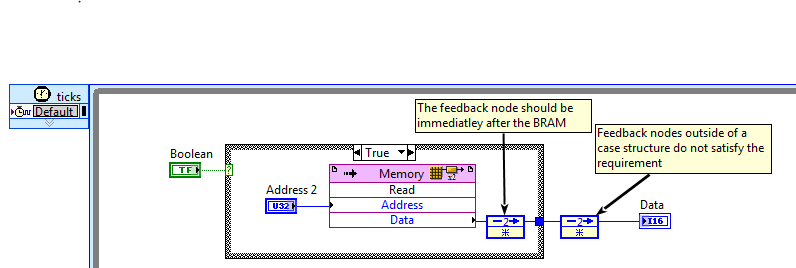

I am using at PXIe-7961/NI-6585.  I am uisng a case structure to implement a state machine.  I am trying to read data from block memory in one case and us that read data in another case on the next clock tick.  I have the output of the block memory wired to a feed back loop outside the case structure (see attached). When I try to complie I get an error Internally pipelijned objects not connected to a feedback node.

BRAM requires the data output to be directly connected to feedback nodes to function properly. This is an inherent requirement of the phsyical component that is instantiated when a memory item that uses BRAM is created. Having the feedback nodes outside of the case structure create a construct that prevents the physical component from accessing the feedback nodes in a way that preserves data integrity, thus the compiler throws an error stating it has not been connected to the requiste feedback nodes.
