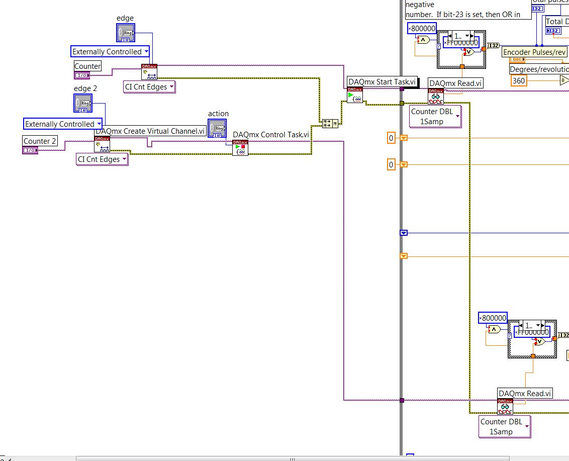

I would like to know how to configure two counters for a single task. At first, I have put two start task for two counters and it did not work. Now, I have put Control Task to control the task of the other counter. Appreantly, all what it does is that it makes one counter work while other is stopped or not working. I have attached a picture of the VI below.

Sorry for any confusion but what I meant is that I want both counters to gather data in the same time. When I put to "Start task" in the VI, it gives me an error saying that you must reserve one of them but when I do that, it makes one counter working but the other on-hold.

We are currently using NI-cDAQ 9191 chassis with NI 9401 Digital I/O module that can use counters. I don't know if the lines for the counters are multiplexed or not. I have attached the VI for you to look at it.
