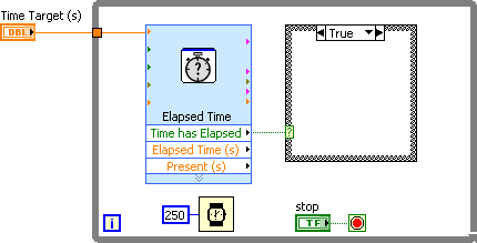

JAMR,
It sounds like you are wanting some form of "break" statement.   This does not exist for what you are wanting.  What I would recommend is having a case structure in your while loop and a counter.  When the counter reaches a certain level, it will then run the code that you are wanting to do every X minutes.  This will then allow the while loop to iterate much more frequently so that you could click the stop button and stop the loop quicker.

Just use the Elapsed time function.
