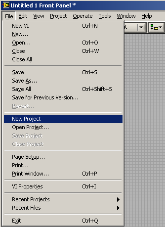

From a VI, you can select "New Project" from the File menu.

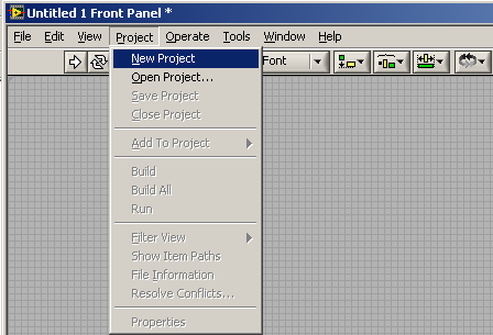

Or easier to simply select New Project from the Project menu.  Or if you get the splash screen at the begninning which offers how to start, you can select New Project.
