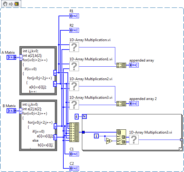

    I attached two vi here. In 2D array Multiplication,1D array Multilication.vi is to be called for 4 times.
     if we call the same base vi for times means the vi executed for the same output irrespective of inputs.
    I had this problem while implementing at the first time. So i duplicated the base file of 1D array-mult.vi as 1D array-mult1.vi, 1D array-mult2.vi, 1D array-mult3.vi in the same folder. In my 2D arra-Mult,vi, i called individual subvis. Then only i got the correct answer.
My ques: Is it possible to call the same base for 4 times in a single vi?

There is no problem (programmatically) with calling the same VI by placing it 4 times onto the block diagram.  You do not have to rename them VI1, VI2, VIn if they all do the same thing, as you have done here with 1D-arrayMult...  It's just messy.
You may need to make re-entrant in certain cases.
A better way to do it would of course be to use a For loop as shown (I left what you did in tact).
Are the two formula nodes identical?  I didn't check.  If so, use a for loop there too.  Build your A and B matrices to a 3D array and auto-index in For loop - single instance of your formula node.

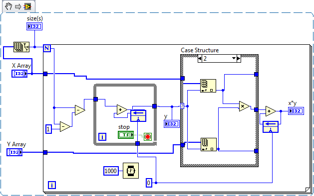

It is quite concerning what you have done in your 1-D Array VI.  I have no idea what it is supposed to be doing, but it appears to be nothing; it is completely wrong.
There are backwards wires, your While loop does nothing (there is not shift-register) - how will it Stop?!, your cases 0, 1 and 2 are all the same!  Timer of 1000ms??! hmm..

      The problem i had experienced is while executing the same function 4 times, all the four outputs from 1D array Multiplication is same. then i duplicated the base vi into 4 different names. after this only i got the correct answer.
       what i did is: In 1D Array multiplication i multiplied two 1D array and got a result of an integer.
      So while implementing the 2D array multiplication, i splitted the 2d array multiplication into rows as well as column terms and i am performing the 1d array multiplication 4 times for 2x2 matrix. Do u got my point?
      For your next question:
            the while loop executes for  2n times  if  a nxn matrix is provided as input and it stops automatically.
In case structure, i used index array function.  i am giving different  index values for the accessing the array element one by one,thereby multiplying that and producing the result.
