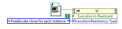

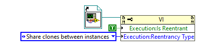

It depends whether this is for:
1. Modifying a VI in a running application:
In this case you simply can't because it requires LV to recompile your program, as @ explained.
So make the VI always reentrant and create as many clones as needed dynamically (1 or more).
Also I don't think this would be a good idea to let a user (non-developer) to choose whether a VI should be reentrant or not.
2. Making a scripting tool for using when coding (target VI is in edit mode):
You can do that by using VI properties:
"Execution > Is Reentrant"
"Execution > Reentrancy Type":
Non-reentrant:
Reentrant with shared clones:
Reentrant with preallocated clones:
Also, you may want to save the VI afterwards to make the changes persistent:
Raphaël.
