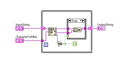

Hi Raj, Yes. You were getting the result as not equal because of the presence of space in your second string.
You can use the function named, Search and Replace to identify space character and replace all of them with null character. Once you do that and the result of this you compare, you will definitely get the result as equal.
I have made an example code for that and the screenshot of that is attached with this post.

Just to know, the soluce from 'sundarganesh' is better because his used native function is optimized Smiley Wink.

Dear Sundar Ganesh and J.DECHET
A very thank for both of you for helping me to solve the problem
The example given by Sundar is what i was looking for . Thank you once again
regards
RajSmiley Happy
