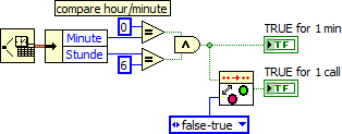

Hi sridhar,
comparing strings isn't the best idea you can have! Your example will also result in TRUE for a string input of "05abcdef"…
When you want to compare numbers you should stick with numbers:
Message 9 of 10
(4,076 Views)
