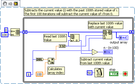

Hi CW81,
I think its something along these lines you are after. The current version of data (i) is subtracted from the past 100th stored version of i. The past 100th stored version is then overwritten by the current version. This cycles indefinately. In this version, until the first 100 iterations have been stored in the array the current value of i will be subtracted from 0.
Hope this helps.
