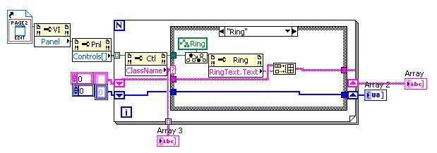

how to control/determine order of call by reference
How do i control or determine the order the controls will come up in a loop like this.  I have a page of controls and want to read write individual data to each one.

The order should be based on the tabbing order, which you can set from the Edit -> Set Tabbing Order... menu item.
Why not just use the Label.Text property instead of the class name?

I'm not sure i understand how label.text would help me. All my labels are different for each control. Oh and thank you for the update about the tabbing order!
look at the control name and act based on what you read.

To my experience, the order is the reverse of the order when you did create the controls (I'm not completely sure about FP controls, this is how I've found BD objects are listed). The only option to change the order is to delete and recreate them.

Nope, it's the tabbing order. Try it. Smiley Wink

Actually, You are both right 🙂
the Z order from back to front is Also the default tabbing order. I'd have to play with it a bit to see if move to back/front changes things.

The problem was there were over 100 numeric indicators on some of the display page and up to four pages of displays.  I have one page for setup on one computer and one for display, this was like 600 or 700 indicators i have to assign channels to.  I didnt want to have to wire each one or recreate them.  i wanted a way to assign a channel to each numeric indicator without having to wire to each individual indicator. Plus i wanted to learn how to use references. I think i have it working, but im still in the process of testing. The numeric indicators are labeled meter x, where x increments so i test for each label name and sort the info by label name.
