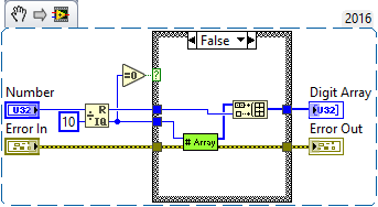

Because you asked nicely, it is less likely that this is your Homework problem, and I love recursion, here is a solution in PseudoCode and in LabVIEW:
     function DigitArray (number: U32) : Array of U32;
        If (number DIV 10) = 0 return [number]
          else return BuildArray (DigitArray (number DIV 10), [number MOD 10])
This is a LabVIEW 2016 Snippet (I'll leave it as a Trivial Exercise for the Reader to supply the True case).  Note that for the function (recursively shown as the little Green Icon with # Array on it) to be recursive, its Execution property has been set to Shared Clone, Reentrant.
Bob Schor
