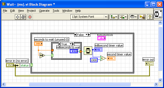

The GPIB Wait function waits for a GPIB bus state to happen and returns As soon as the state is observed Or timeout is reached.
Use the Wait +(ms).vi in the Traditional DAQ Counter sub-palatte. to Wait for time.  If you don't have DAQ  installed you can make a sub.vi that looks like this
