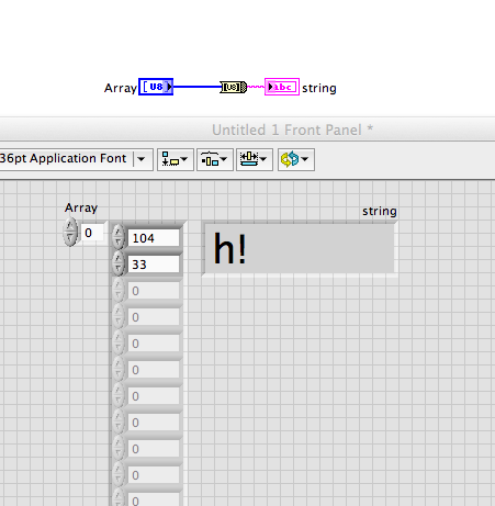

PKIM,
Typecast is not the function to use for what you want to do. It forces the binary representation of the data to be re-interpreted as a different datatype. The Extended datatype is particularly problematic as it uses different binary representations on different platforms.
1. You should use a binary datatype, specifically U8, for numbers which will be converted to characters in a string.
2. If the input is U8, typecast to string actually works.
3. For an array (of U8) use the Byte Array to String function.
4. To convert a string to an array of U8 use the complemantary String to Byte Array function.
5. These functions may be found in Nuumeric >> Conversion or String >> Path/Array/String Conversion palettes/
Lynn
