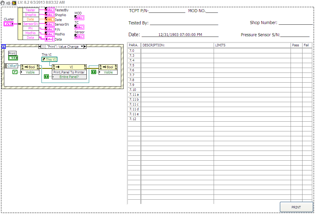

One thing I do when I want my report to look like the silly test specification, without doing any fancy HTML, is to build a Front Panel to match the report I want and print an image of that.

All you need to make is a VI with a conector pane that takes all of the report information onto the FP.

This is a lot nicer than what I did but mine data just went to a printer...no displaying to operator and no option to print.  It was printed regardless at the end of the test.
