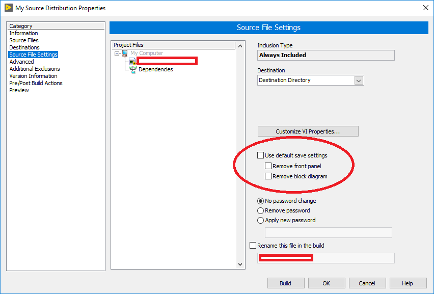

@HARRY78 wrote:
how disable & disappear block diagram
When building a source distribution, there is an option to remove diagram and front panel. NO scripting needed.
This is relatively safe, because it does not modify the original code. Still it is quite pointless.
