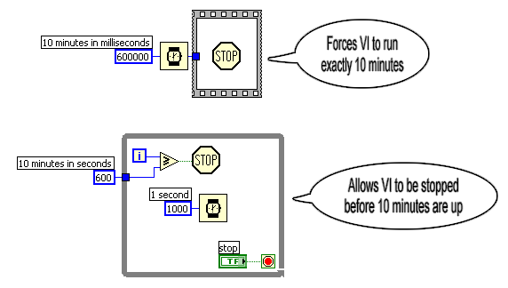

Here are a couple of easy ways:
Message Edited by Warren Massey on 02-16-2006 07:18 AM

hi folks,
i tried one of them on my vi, which is very very messy, but it works.......(somehow!), can anyone alter this so it halts after 10mins?

Attached is an example of how you could stop your VI. I've used the Elapsed Time Express VI. I also included a stop button as it's better to stop it that way then by using the Abort button.
Sarah
