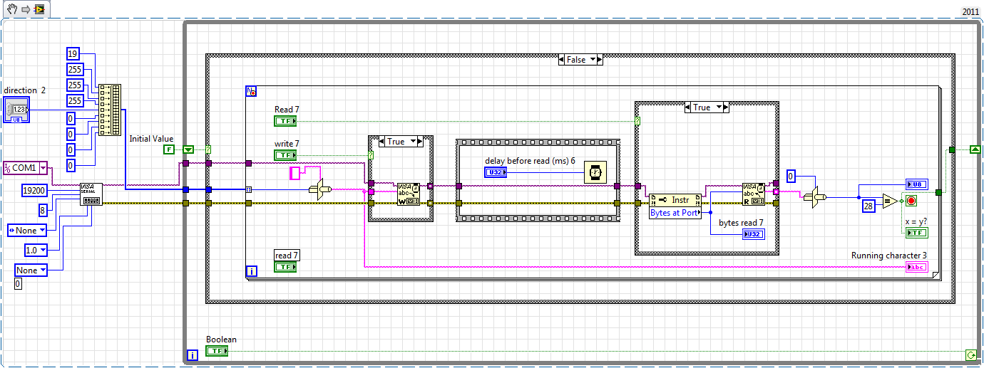

how to execute a while loop continously without iterating the for loop inside if a condition is satisfied
I am attaching a VI in which when the reply 28 comes the for loop should stop and while loop should continue iterating. Can you show me one way for it

You can stop the for loop when a certain condition occur: https://www.ni.com/docs/en-US/bundle/labview/page/stopping-for-loops-when-a-condition-occurs.html
Add a shift register to the while loop and implement the functionality like below:
