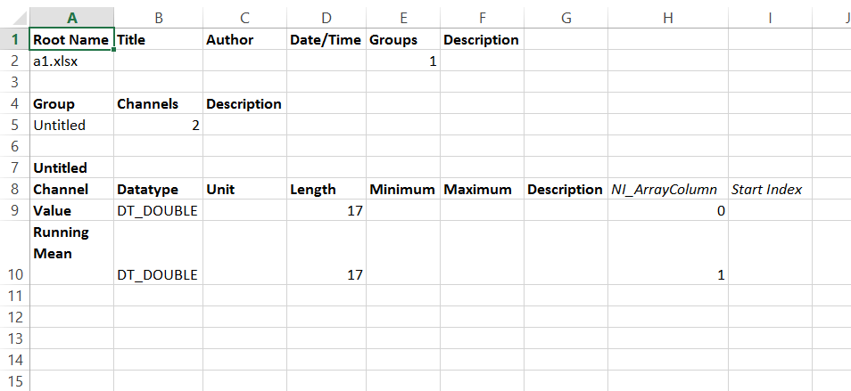

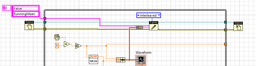

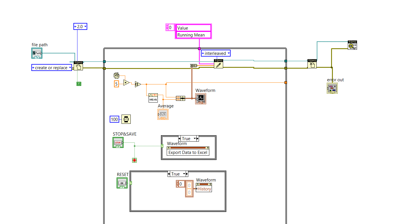

Hey Jeff, and other Labview individuals 🙂
I am currently stuck&confused. The TDMS does not give me what I want.
So basically, for testing purposes, I have a TDMS and a "Export Data to Excel". So every test run, I get two spreadsheets.

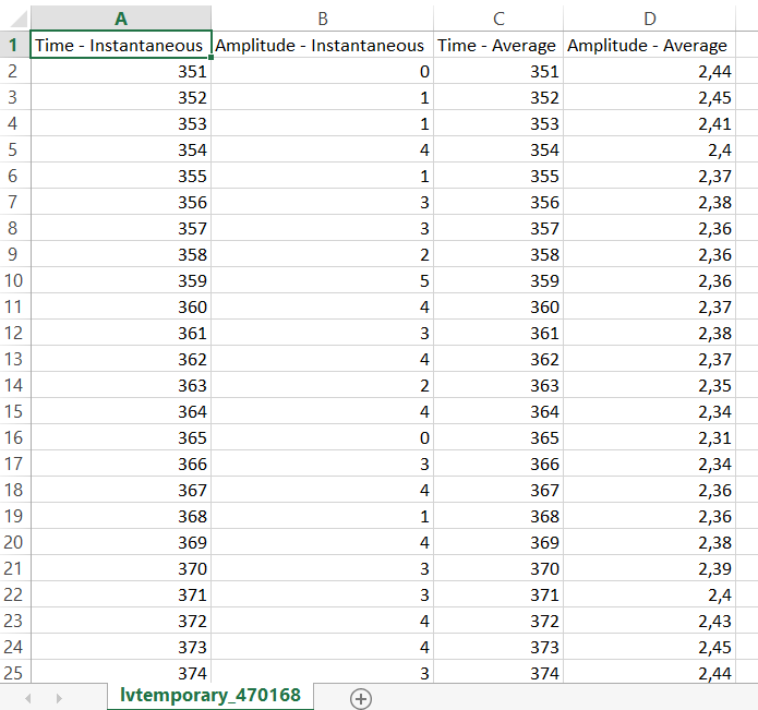

The "Export Data" function gives me the following
This is what I want, except that it only gives me the past 100 points. I want everything, from start to STOP.
Here is what I am getting with the TDMS
Quite different. Not really what I want.
Am I supposed to modify the TDMS differently? Maybe use different functions?
Kindly let me know, thank you.

It looks like you have a chart so the export will write the history length. What do you have it set to?
Message 7 of 12
(4,863 Views)
I have it as default - I didn't modify, nor do I know how.
Can you briefly explain?
Message 8 of 12
(4,857 Views)
Right click on the chart and view the history length setting.
Message 9 of 12
(4,851 Views)
It's set as 1024 - much bigger than 100, and not what's displayed on the spreadsheet 😞
